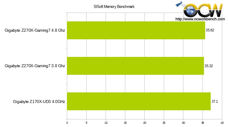

At 100MHz BCLK running DDR3-3200 using XMP Profile#1, we can easily see from the memory benchmarks, the Kaby Lake running the Core i5-7600K is slightly lower at 35.62 GB/s.

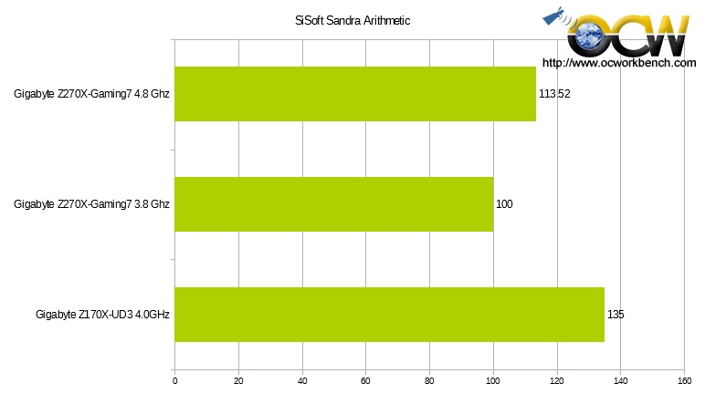

In the Arithmetic tests, the Core i5-7600K scored 113.52 GOPS compared to just 100 GOPS running at default. A 13% improvement can be seen pushing it up by 1GHz in clock speed with a multiplier of 48x.

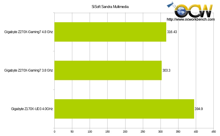

In Multimedia test, the performance jumped from 303.3 to 316.43 Mpixel/s, a 4.3% gain.
