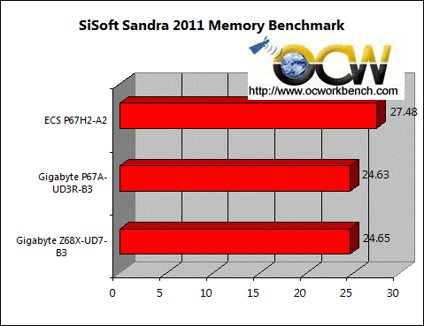

Before deciphering the benchmarks, we have to put forward the slight differences in the test platform. Other than the two Gigabyte boards in the comparison test which runs a set of Kingston high profile DDR3-2000 at XMP #1 profile -DDR3-1866 C7-8-7-20-1T, the ECS P67H2-A2 is paired with a pair of Kingston DDR3-2133 modules runnign XMP #2 profile. Although XMP profile #2 is chosen which is suppose to run at DDR3-2133 C9-11-9-27-1T, it is reported in CPUID as CAS 10-12-10-28-1T. Other than that, the basic configuration is exactly the same for the three boards in test.
First, we take a look at memory bandwidth. Needless to say, running at DDR3-2133 gives it better memory throughput at 27.48GB/s in the dual channel configuration. This exceeds the two other boards which ran a similar pair of modules at DDR3-1866 C7-8-7-20-1T.

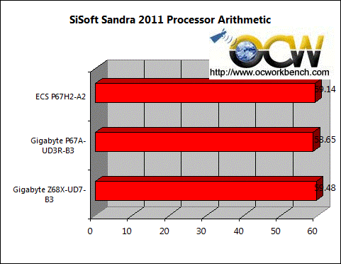

Processor Arithmetic tests the processor performance and from the graphics, we can see that ECS scored 59.14 while the Gigabyte Z68X-UD7-B3 based on Z68 chipset seems to do slightly better at 59.48.

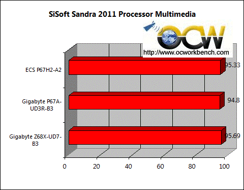

In Processor Multimedia, we see that the ECS P67H2-A2 outperforms the Gigabyte P67A-UD3R-B3 but falls slightly behind the Gigabyte Z68X-UD7-B3.

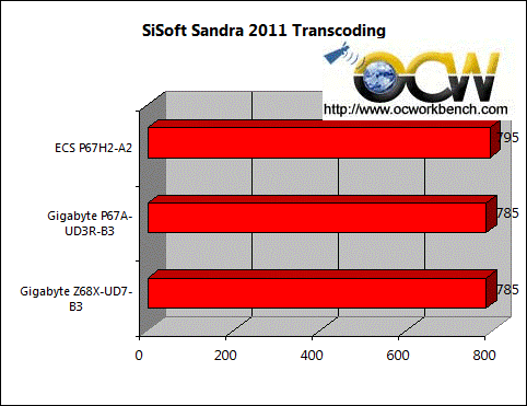

In Media transcoding, we see that the performance is largely related to the graphics processor. The speed difference would probably correlate to the speed on encoding video clips. The ECS P67H2-A2 seems to have an upper hand.
