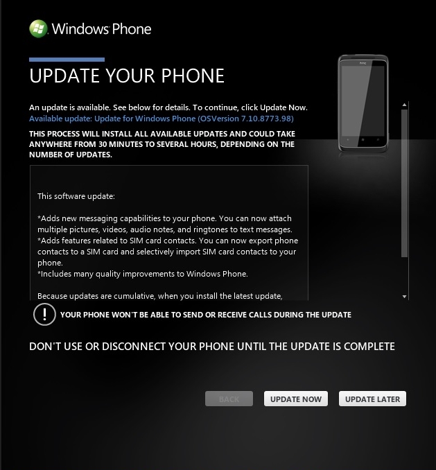

I did a search on the net and discovered that the old trick that we used to update to NoDo is able to trick the servers to push down the updates. We did it again and was successful to get it updated to the latest OS.
The trick is to unplug your network cable or USB network adapter at the 6 second after you click on the UPDATE button.
Here is how to go about it :
1.  Power on the HTC Trophy 7
2.  Switch the phone to AIRPLANE mode
3.  Connect up the USB cable and let it detect and install any drivers (if necessary).
4.  Run Zune
5.  Click Update and count till the 5 or 6 second
6.  Pull out the network cable or USB WiFi adaptor
7.  Wait for Zune to display “An update is found”. If it says “You are having the latest update”, proceed to step 5 and try it again.
8.  Plug your Ethernet cable or USB WiFi adaptor back to your system.
9.  Proceed with the update.

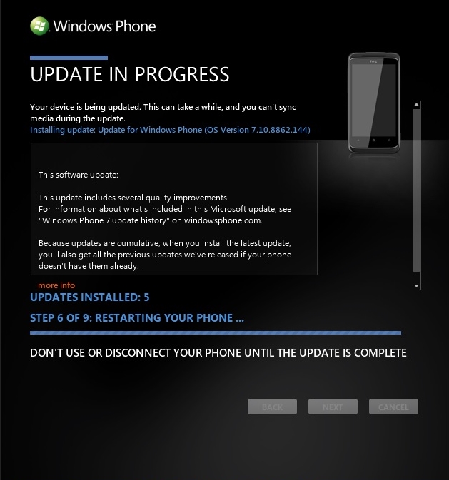

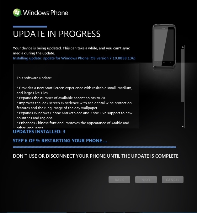

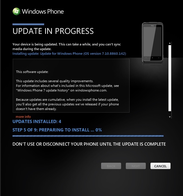

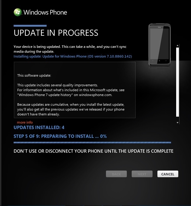

The update is automatic and do not need any human intervention. It will go through a number of updates depending on your latest OS update. Most users will start with Windows 7.5 as it was the last available update to most Trophy 7 users.
Below are the screen shots of the update process.

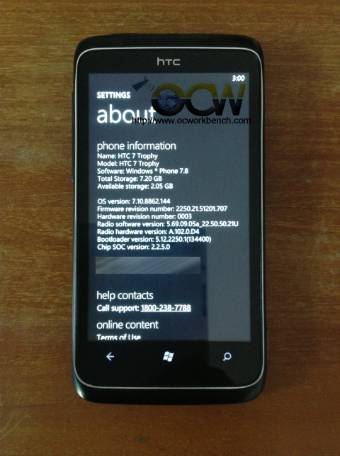

You can now resize the Live Tiles and get all the fixes applied to your HTC Trophy 7.
