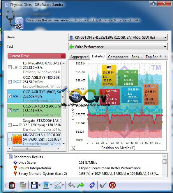

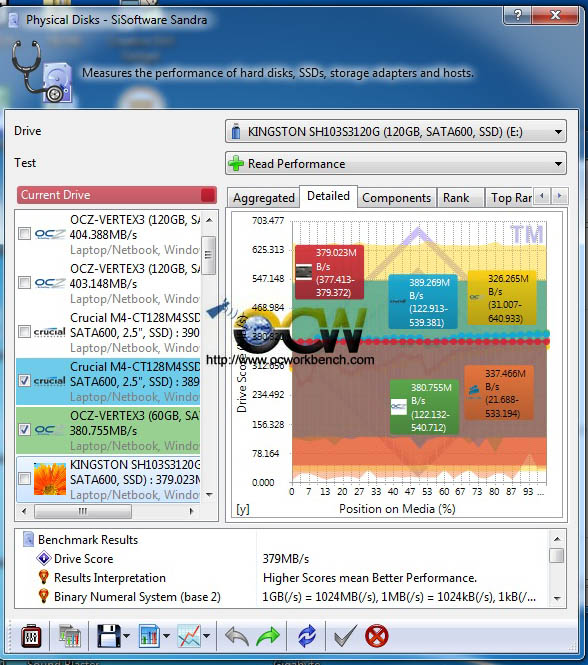

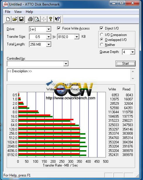

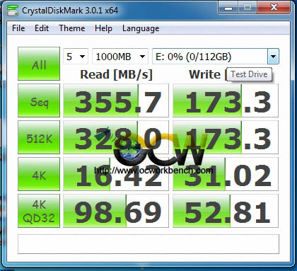

Below are the results using Thunderbolt (other screen shots refer to Gigabyte section of http://forums.ocworkbench.com).

SiSoft Read |
SiSoft Write |
Atto (Read/Write) |
CrystalDiskMark (Read/Write) |
Direct Connection to SSD |
455.92 MB/s |
100.64 MB/s |
527 MB/s / 579 MB/s |
454.3 MB/s / 173.1 MB/s |
Thunderbolt |
379 MB/s |
161.87 MB/s |
352 MB/s / 389 MB/s |
355.7 MB/s / 173.3 MB/s |
USB 3.0 |
108 MB/s |
66.66 MB/s |
119 MB/s / 118 MB/s |
112.4 MB/s / 115.5 MB/s |
