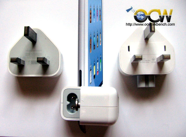

On the left is the charger for iPhone 3GS. On the right is the charger with adapter (middle) for new generation iPad.

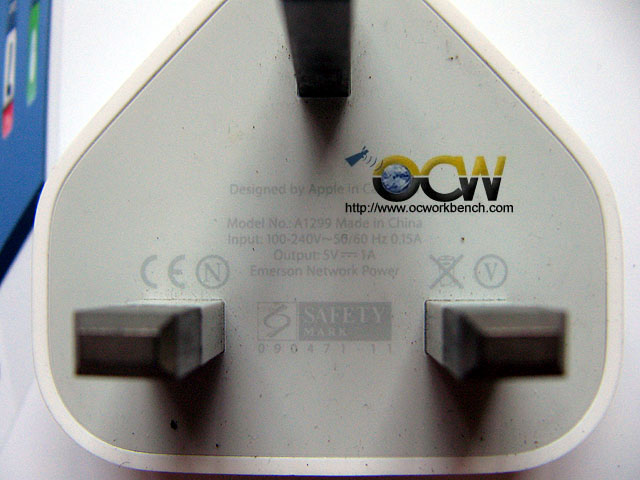

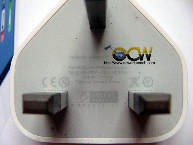

The picture above shows the original iPhone 3GS USB power adaptor with Input of 100-240v 0.15A, output 5v, 1A.

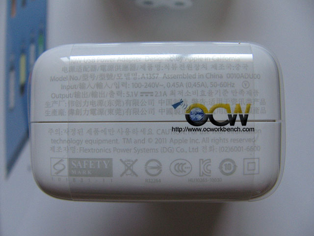

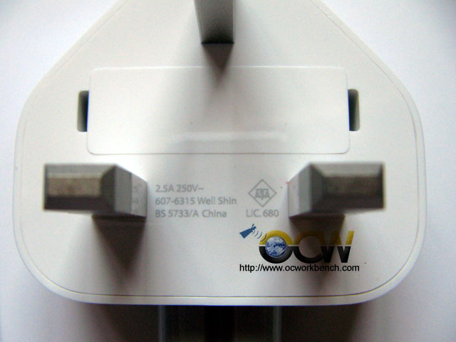

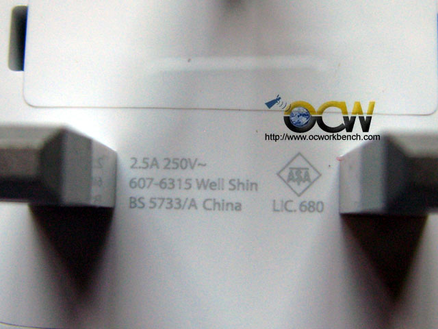

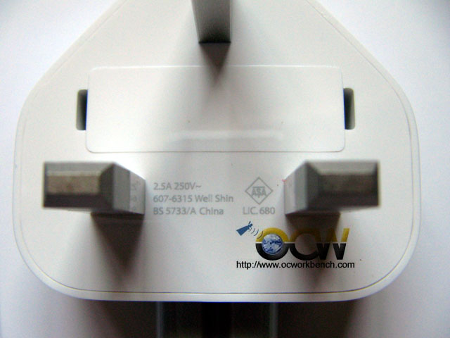

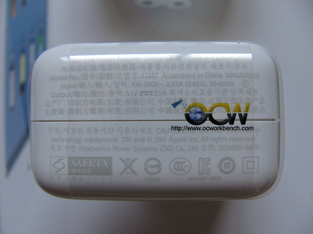

The picture above shows the new charger that outputs 2.5A, 250V and the adaptor has an input of 100-240v 0.45A and output at 5.1V 2.1A.
The new Apple iPad was released a couple of weeks ago. We did an experiment, charging it using with an iPhone 3GS charger. It simply took forever to charge. We estimate that it takes around 1 hr to charge 10%. If the standard iPhone charger takes so long to charge, we can confirm that the new iPad probably require more power to charge it.
We then tried it on our HP notebook and ASRock NetPC (both with USB boosting software installed). Both machines have no problems detecting and charging it (prior to installing the driver, it won’t even charge it).
We took a look at the charger and noticed the differences in the iPad and iPhone charger, the output rating is quite different. With the driver installed, the iPad can still be charged but it will be at half the speed compare to if you charge from the power plug supplied.
