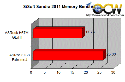

Memory Bandwidth
It is not surprising that the memory bandwidth is better at 25.33GB/s. This is largely due to the removal of memory restrictions on the Z68 chipset. Now we get bandwidth result very similar to those of the P67.

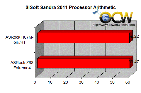

Processor Arithmetic
When it comes to processor test, both did not differ too much since both boards used the same processor.

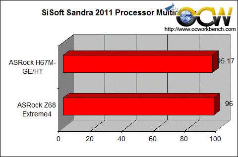

Processor Multimedia
As for multimedia, the result is only 1 mpixel/s away at 96.

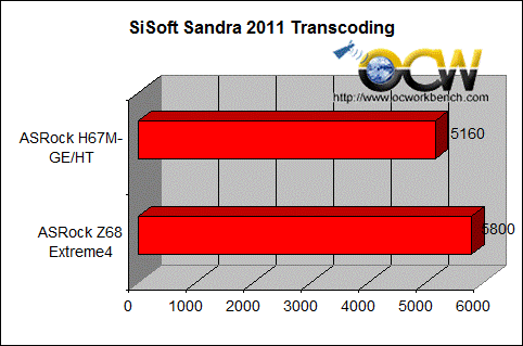

 Media Transcoding
In media transcoding, the Z68 does a slightly better job at 5.8MB/s in the media transcoding test.
