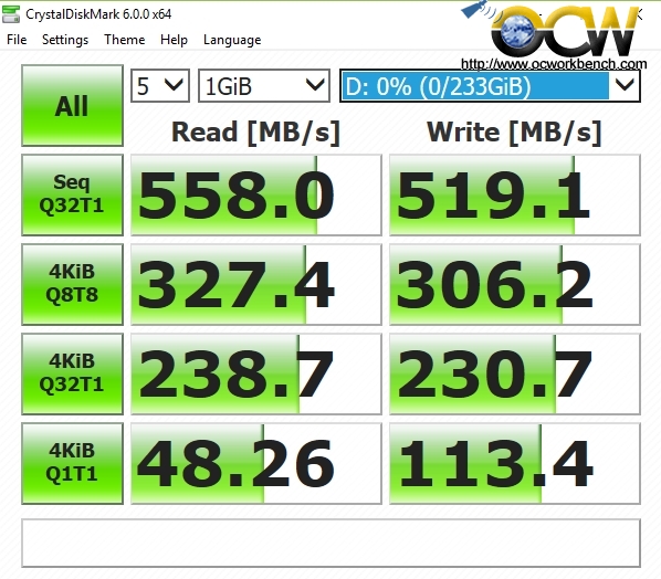

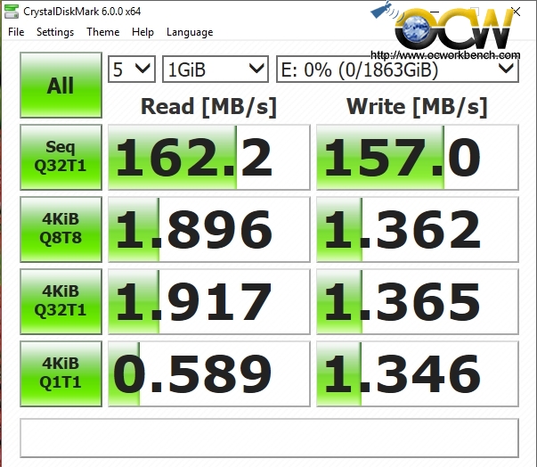

Our setup comprises of a Windows 10 OS on our Kingston 120GB SSD which will not be used in the test. We will begin by measuring the Crystaldiskmark speeds of the WD 2TB HDD and the Samsung 860 EVO 256GB M2 SATA.
Below are the results of the Samsung 860 EVO M.2 SATA followed by the WD Blue 2 TB  HDD.

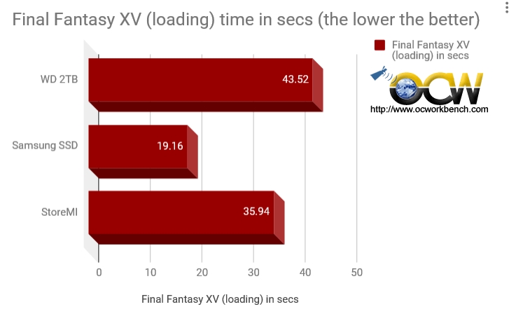

After which we tested the loading times of two benchmark softwares. The two applications are Final Fantasy XV and World of Tanks Encore. We took down the timings it took (for the 1st instance when we click start benchmarking till the first frame of the benchmark. The test is done with the HDD and SSD separately connected to the motherboard with the games loaded in the Drive D and not in the boot drive.

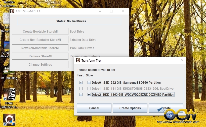

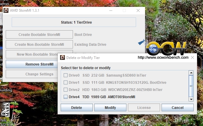

After the numbers are taken, both Samsung 860 EVO and WD 2 TB HDD are remounted back to the mainboard and Store MI installed. A Tier consisting both drives is formed as Drive 4.
After that is done, the system is rebooted and the loading times of both applications are taken. The game is installed on the newly formed StoreMI drive.

Base on first the first reading after a system reboot, the reading shows that it took 43.52 seconds to load the benchmark from the time we clicked the benchmark button till the to the 20th frama of the benchmark when the first graphic appears.

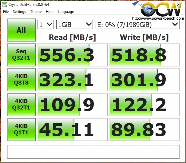

The above is the CrystalDiskMarkinfo Score of the newly built StoreMI volume. The results are close to the results of the Samsung SATA M.2
Using a standalone 860 EVO, it only took 19.16 seconds to load. Once we implement StoreMI on the system with the two drives, the loading time from the StoreMI drive was down to 35.94 secs.

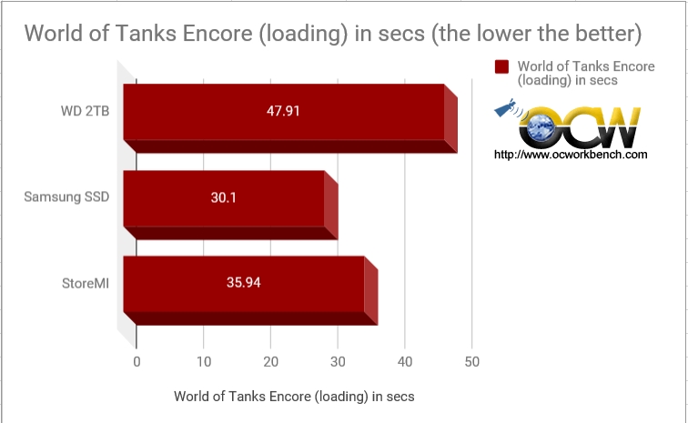

Similarly, we did the same for World of Tanks Encore. It took 47.91 seconds to load on the WD 2TB HDD but took 35.94 secs, a slash of almost 12 seconds. If the 960 EVO is used, it took only 30.1 seconds to load.
