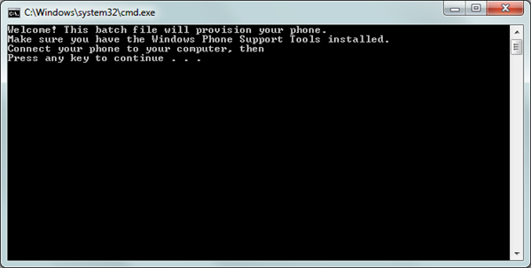

Step 1: Make sure Zune isn’t running and extract the updating tool you’ve just downloaded to the C drive’s root directory (C:\) and run it as an administrator (right-click on Update.bat and select “Run as administrator). Let the tool do its thing.

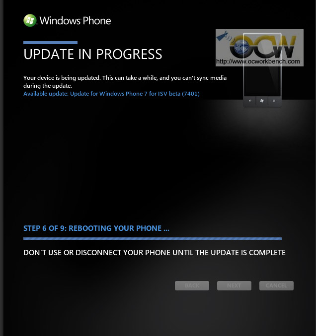

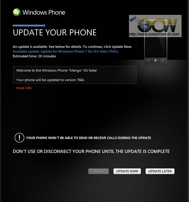

Step 2: Zune should automatically launch when this process is finished. Once you check for updates, the program should display the “Windows Phone 7 build 7401” update: install it. Once it’s done, check again, and look for the “Windows Phone 7 Mango build 7661” update and install it as well. That’s Mango.
