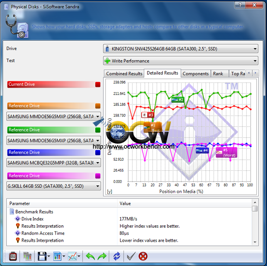

Write Performance with SATA interface
From the chart, the write performance is at 177MB/s which is way ahead of the most of the Reference drives used in SiSoft benchmark. The Samsung 256GB (green coloured) is still way ahead at 211MBp/s in write.

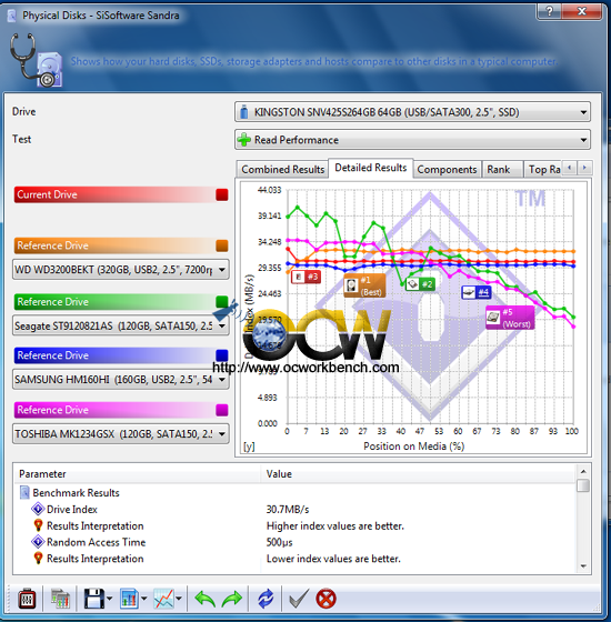

  USB Performance
As usual, USB will always be the bottleneck for the SATA3Gbps connected SSD. As we can see from the chart, it’s performance for read  is 30.7MB/s and a write speed of 32.29MB/s
