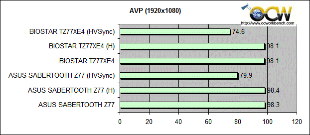

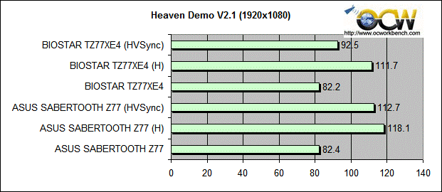

We ran the test by pairing up the board with a HIS 7970 Graphics card running Catalyst 12.4.

In Heaven Demo v2.1, the scores didn’t differ very much. Onlyt when Hyperformance and VSync is turned on, the result dipped in the case of Biostar TZ77XE4.
In AVP, the SABERTOOTH Z77 maintains the lead and the differences is widen when HyperFormance and VSync is enabled.
